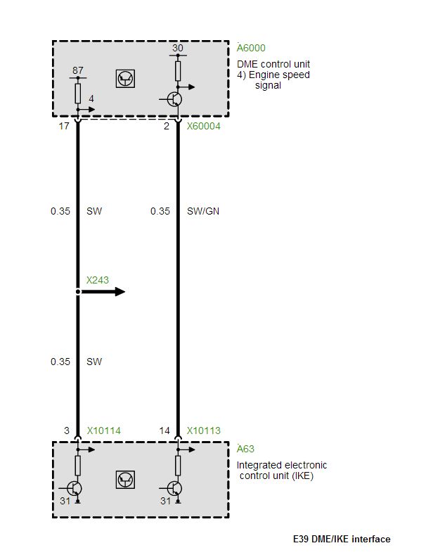

    Now that the cluster is re-coded, you need to do some wiring, so that the instrument cluster can get the analog signals that it is now looking for. The tach signal wire will usually be in place but check it, here is the WDS wiring diagram:
    Make sure that the wire #3 on connector x10114 goes to the tach signal and it will work (verify the wiring diagram for your level of instrument cluster just to be safe).

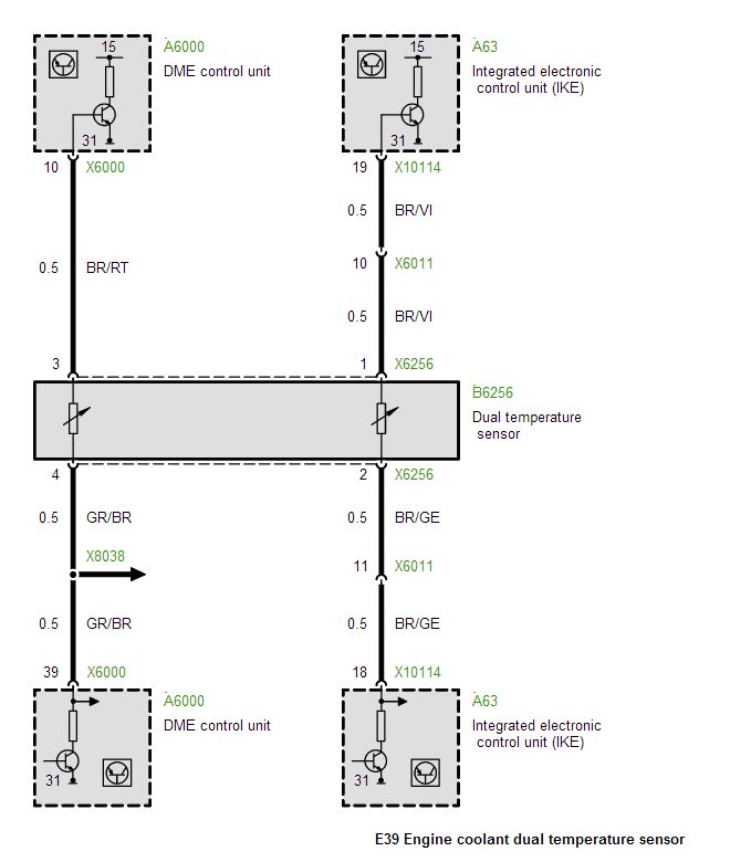

    Here is the coolant temp WDS wiring diagram:
    For the coolant temp signal, one wire will usually be missing, so make sure that they are both there by adding a wire to the connector at the missing pins #18 and #19 on connector x10114 are connected to your BMW coolant temp sensor (again verify the wiring diagram for your level of instrument cluster just to be safe).
